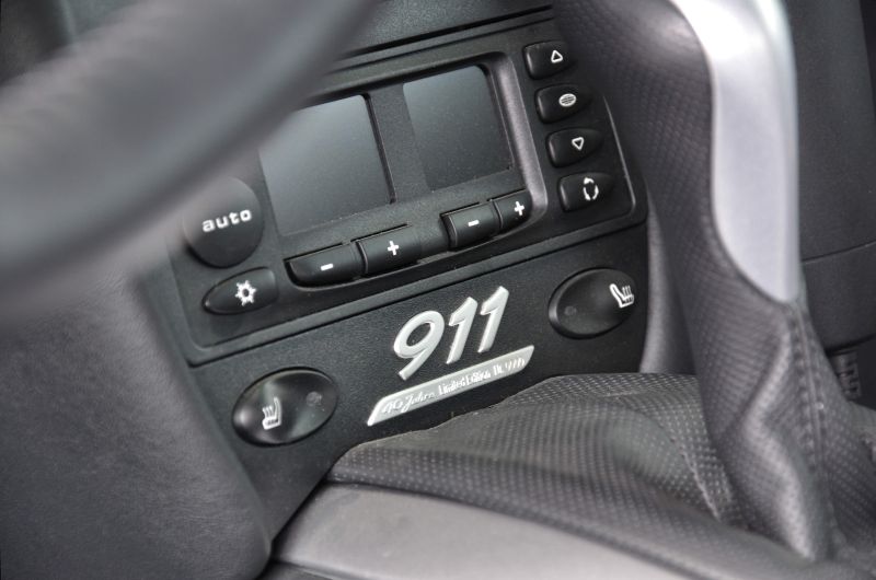

The easy, but expensive, way would be to find a pair of heated seats, and swap them. The wiring is fairly easy, as the control units (relays) are mounted in the seat, and you would need to run the wires to two switches on the 'batwing' and a 12v feed from the fuse box. You also need to run a wire from the switches to a bridge plug on the relay panel for the switch illumination.
I believe there are heated seat kits around, but they would need the elenents fitting to the seat, and the control system wouldn't look 'factory'.

It's what our American cousins call the small panel at the bottom of the centre console where the heated seat switches go, due to the shape.
