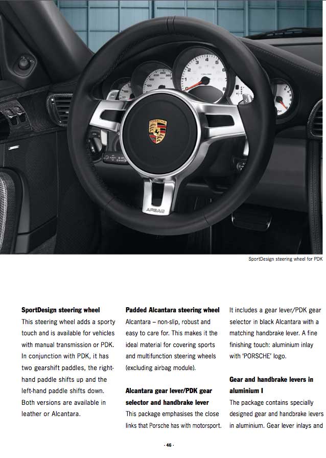

If you are meaning fitting the SportDesign steering wheel to a PDK-equipped car that has the 'button' steering wheel as standard, then this is an option from the Tequipment range.
I have just bought a 997.2TT which was factory fitted with the button wheel, and the dealer kindly swapped it out to a paddle wheel FOC. The price you mention is about right.
Aside the Turbo S, not sure any PDK cars have paddle wheel as 'factory'...?
From Tequipment catalogue:
"SportDesign steering wheel
This steering wheel adds a sporty touch and is available for vehicles with manual transmission or PDK. In conjunction with PDK, it has two gearshift paddles, the right- hand paddle shifts up and the left-hand paddle shifts down. Both versions are available in leather or Alcantara."

I'm pretty sure the Porsche Tequipment paddle wheel also will be a straight swap (but not free!) - the only issue would be if the car has a multi-function "button" wheel as the paddle wheel doesn't come with "multi-functionality"! Methinks your Porsche dealer might have talking out of his exhaust pipe but I will consult with mine (who do know their stuff[;)])
