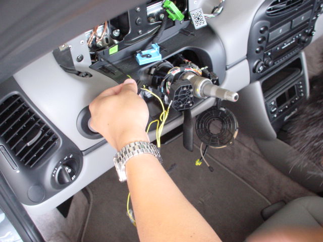

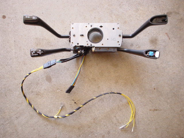

The retrofit is easy, and just requires the stalk and a couple of connectors and wires. Once fitted, you have to get the instrument cluster coded by someone with a Porsche System Tester. Shame you are so far from me. You can get all the info from www.renntech.org, or drop me an email and I'll attach a DIY to a reply.
Done about 100 retrofits over the years. Not hard to do. Need the steering column switch assembly with the OBC stalk, 5 VW wires, and an electrical connector to plug in the stalk.

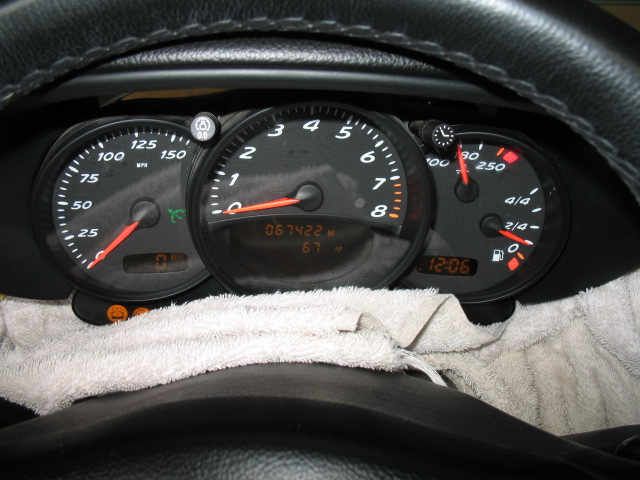

There is a third option for the new style cluster. You can run a single wire from the instrument cluster connector to ground. When you turn on the ignition you will see the outside temp display.
That is this picture. You can see the ignition is on because or the cruise control indicator. You can see 67 degrees displayed right below the odometer display.
In this picture the ignition is off. The temp display has reverted to the trip odometer display. The trip odometer display is zeros because we had the battery disconnected.

If anyone wants an OBC retrofit kit, complete with 3-lever stalk, wiring harness, and instructions, drop me an email. It is suitable for 996 (1997-2001) or 986 (1997-2000). £85 including P&P to a UK address. Otherwise it goes on eBay at the end of the week.
