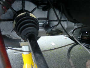

Can anyone tell me where I can locate the switch for the reversing lights.
My lights seem to be "intermittant" and after checking the lights, I want to check the switch, but it is not obvious from my manuals where it is located.
Any help welcome!
Lazza
sender is on the gearbox, but the loose connection could be anywhere I guess...
(see the lead next to drive shaft)

Mine doesn't work either . . . . I've checked the connection to the sender Gav mentions and they seem fine. If I disconnect and hold the two wires together with the ingition on . . . the lights should come on . . . right?
If they don't the switch needs replacing (or the pin needs sorting).
We are certain this is the switch (as per Gav's piccy) as I searched Pelican and they all reckon the switch was on the tip/end of the gearbox . . . . presumably they're talking about later boxes . . . right?
Phil
The switch for the gearboxes of our vintage are on the right hand side. I know as I've had to reconnect the wires to mine many times!!!
