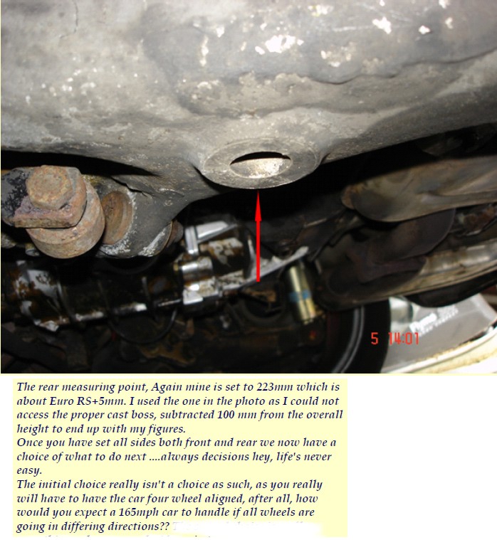

I don't remember having to remove the fin. You might want to remove the rear wheel to aquaint yourself with the measurement point which from the boss on the bottom of the rear suspension arm. Don't forget to drive around to settle your suspension afterwards.
Here is a photo and write up I copied from but can't remember the website that I used when I did mine.
Thats from my website write up.

Hi Kevin, the write up on your website has been a great help to me during my studies on my forthcoming suspension change, it's great that Porsche enthusiasts take the time to share experience and knowledge. I hope to do the same once I really start to get my hands dirty.
Anyway I managed to find the rear ride height measuring point that I was looking for and I did have to remove the shark fin. No measurements taken yet as the car is not fuelled to the correct level. Took a couple of pics whilst I was on....
