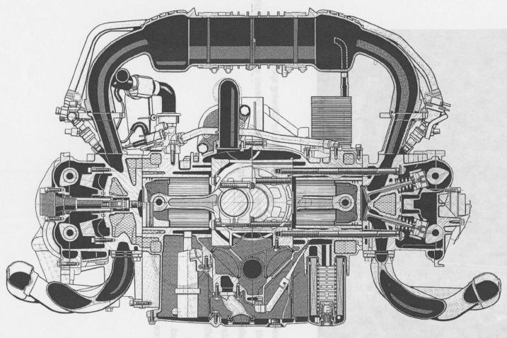

The intermediate shaft is the one which drives the camshafts. It runs parallel to the crankshaft, lower down the crankcase. At the flywheel end there is a bearing, and a cover which is just under where the crankshaft comes out the crankcase (sealed by the RMS). The seal on the intermediate shaft bearing cover is also prone to leaking, and most indies change them at the same time as doing the RMS. It is impossible to tell which is leaking (IMS or RMS) without taking out the engine and removing the flywheel.
If it was mine, I would just keep an eye on things, and have it fixed when a new clutch is needed. If it gets to being more than just the odd drip on the garage floor then that would be the time to reconsider.
