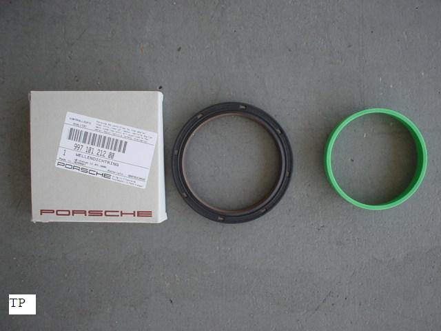

And he might have to do it all over again. He used 999 113 490 41 which is the 3rd generation seal. The 4th generation seal, 997 101 212 00, has just been released.

The green plastic ring is used to slide the seal over the shaft so it does not get nicked. Then the green plastic thing it is removed.
Make of that what you want, in my best Brit-speak.
Since you are now famous, I thought of buying a seal and getting your autograph.
2 local guys will have this seal go in.
Stay tuned.....
