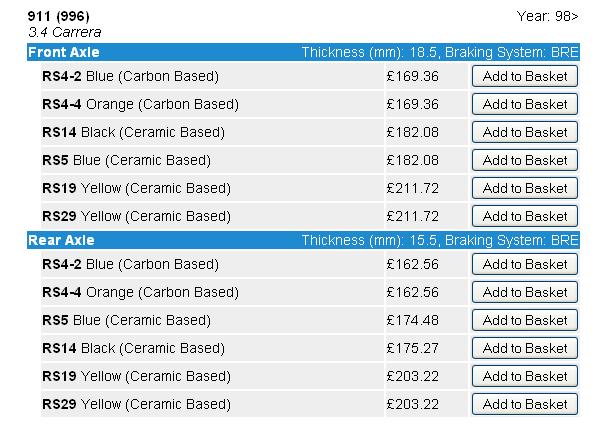

I didn't think Pagid do a RS-15 in standard carrera sizes?
Personally, I use Performance Friction PF06's all round. An excellent track pad and acceptable on the road. Price is right too. They are a tad dusty though, but not nearly as bad as the 97 & 01 versions.
Friction level isn't as high, but sounds like a reasonable choice all the same - seems quite similar to the trusty old RS-29 in fact.

RS29's
I wanted greys, but couldn't get them in time.
ended up with the 29's and rather glad I did.
no issues on road, and great on track
