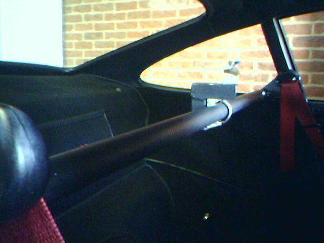

Thought you might be interested in seeing my "el cheapo" camera mount and bar. The mount is simply two pieces of 1"1/2 steel angle welded together to form an L as in the pic then simply drill holes to accept a exhaust clamp for the chosen dia of the bar you are using. dril a hole in the top so you can thread a bolt of the chosen size to corespond to the one on your camcorder. for extra stabilty weld a small steel dowel or thread to help locate the camera. It works and the whole thing costs next to nothing. Only minor downside is that it's a bit fiddly getting the bolt into the camcoder. You could make a T section which would make things a dodle.
The bar and end pieces are made from some scrap i had lying around there is a flat plate at each end welded to a smaller diameter tube the bigger diameter bar that has the mount attached is slipped over the smaller tubes at each end and bolted in place then the hole lot is bolted to the seat belt point (like the brey krauss design)
