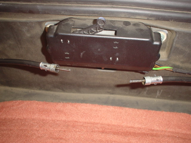

Raise the clamshell by hand. Then put the top in the service position. Under the clamshell you will see 2 black cables that go to the top motor. You will know what is the motor because you will see electrical wires to it.
The cables are attached to the motor via brass clips. Remove the brass clips then pull the cables away from the motor. The cables are like an old speedometer cable. You will see a square ended drive. The square end should stick out about 3/4". The top motor spins this square end. You also want to see if this part has broken.
This is a 1997. Your 2000 will look like it but not have the lever on top of the motor.
