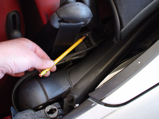

Hi Mark. As I said, I bought the new hood off ebay and either it came without a wiring harness or it was thrown away with the packaging. Anyway, I don't have one and wondered where I can purchase one or I could possibly make one. I presume the wiring plugs into the socket behind the passenger seat as below.

I'm not sure if a post 2003 986, or a 987 loom would work - but that might be worth looking in to as well. Your nearest Porsche centre parts dept would be happy to help.
