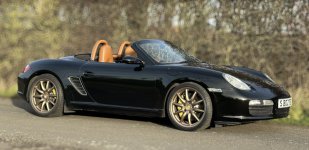

Hi everyone, this is my first post on here and I’m hoping you can shed some light on something that is bothering me.
I purchased a 987.1 late 2007 model Boxster S last October. It has graced the pages of 911 & Porsche world a number of times under the ownership of Johnny Tipler.
The car is great and I’m loving my first Porsche ownership experience, however it has a niggle that is bothering me.
On first start up, it fires up fine on choke, then as it goes through the process of gradually backing the choke off it becomes pretty lumpy, it only lasts a few minutes and when the car is up and running to temp it doesn’t skip a beat. The reason I am concerned is it seems to have got worse in the last six months.
I would be very grateful to hear your thoughts and suggestions. IMG_8316.jpeg
