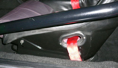

If you want equivalent seats to an RS you should get the Recaro pole positions that are also in your link. The RS/CS ones you mention in that link are more of an aftermarket racing shell (i.e. not a pattern ever used by the factory).
Unfortunately you wont get the proper seats for the 964 RS or NGT anymore. Nothing currently for sale from Recaro is identical. If you want to be totally correct that is. I have moulds of 964 RS and 964 NGT seat shells in order to make exact copies, however if you plan to race the car then they are not FIA approved.
NGT seats are 30mm narrower than the standard RS leather seat. The current Pole Positions and SPG seat shells both differ from correct RS items. Pole Postion main difference is there is less ribbing on the seat back and the top of seat head rest is curved instead of flat across. SPG is correct on the seat head rest top and has almost identical ribbing. Main difference with these is the raised lump on the shell through the main curve on the side of the seat and the plastic bezels around the harness holes.

Yes the seat side mounts for the clubsport seats are totally different to cater for the 30mm narrower seat shell. Porsche took this opportunity to move the drivers weight nearer the centre line of the car. Apart from obvious benefits you also get a better driving postion in front of the pedals and 30mm further away from the cage on side impact.
I've loaded a picture of a correct M003 seat mount. Notice how the side of the seat is much further away from the centre line of the seat runner. The side of a normal RS seat / mount is directly above the centre line of the seat. I'll post another pic of that.
This explains why it so hard to fit harnesses on the drivers side then. Modern harnesses come with the eye bolt connectors and I couldnt get it fit without fouling the runner. I know the earlier belts all used bolts and flanges on the belts, but they aren t as common on the market these days. I did consider getting new runners, glad that I didnt.
