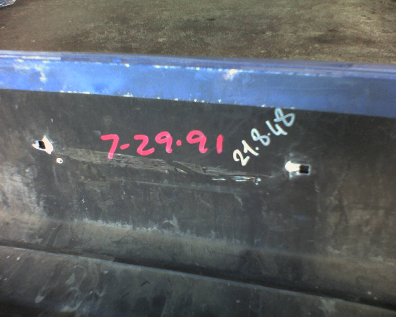

I found a date written on the inside of my rear bumper a couple of years back. This kind of ties in with the 'end build' date of my car which was 05-08-91
Yet another nugget of useless info. [:D]
