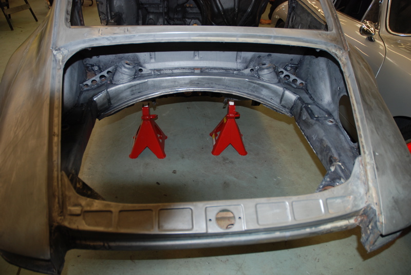

I am nearing the end of converting my 911 to run an RSR Coilover set up. The torsion springs will be deleted in the process of course. I have also had to strengthen the rear shock towers to take the load from the coilsprings.
I should be done within a week so will post back here how it went.

yes, the whole conversion is RSR rated shocks and springs (including helper springs), removal of all torsion bars, and necessary strengthening of rear shock towers.
Looking forward to how it feels....
Post some pictures when you are done if you can. My shell has been modified and strengthened ready for this conversion.
