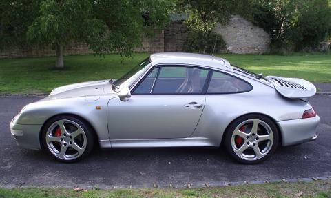

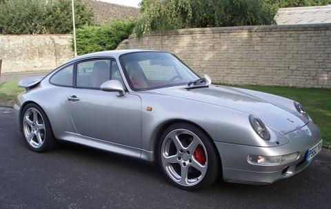

After many months finally got round to fitting the RUF 5 spokes for Eynsham which was just down the road from me so that they could use it for display purposes! and then they didnt use it!!! - pictures attached.
Still reckon they look the best wheels for the 993 Turbo.
Also after 9 months of dithering picked up a set of Fabspeed Muffler bypasses of ebay for £120/$200 and had them fitted, wow are they loud, especially when the engines cold. I can confirm the resonance problem between 2400 and 2800 rpm, fortunately its below my cruising speed. So for those of you that want a bit more noise then RSR, Maxflo mufflers are the way to go. If you want lots more noise, then muffler bypass is the way to go[FONT=verdana,geneva"]

You will find a set every couple of months on ebay for between £950 and £1500 occasionally with tyres, there is a set up at £1350 just about to run out. I got mine of Piston heads second hand of an 05 996
http://cgi.ebay.co.uk/RUF-19-Porsche-996-C4S-or-Turbo-Wheels_W0QQitemZ110029080779QQihZ001QQcategoryZ10408QQrdZ1QQcmdZViewItem
The fronts fit straight on, the rears need 26mm, Ruf say 28mm after buying 26mm I will need my arches slightly rolled as they touched the other day going over a sharp speed bump, my car is on std suspension with new dampers.
