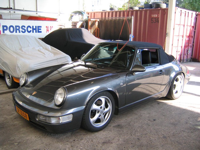

P.S. My first 964 attached.....I miss her.[8|]
