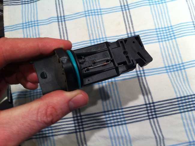

I had removed the MAF and cleaned it.
The odd thing is the car runs perfectly fine for sometimes over an hour then will give the symptoms of fuel starvation, ie it will actually die whilst driving although on occasion will bump back into life, and this progressively gets worse. I have left the car for 2 days now untouched after it ran so badly, and drove it today it all was fine again ???

Ok, I have now replaced the MAF sensor, for a genuine one, and replaced the fuel and air filters and changed the oil and filter (not that it is that relevant). The car will drive normally for sometimes over an hour then without notice it begins to hesitate on acceleration which quickly develops to what can only be described as fuel starvation. It cuts out even when driving along, it is not speed dependent or affected by revs...
