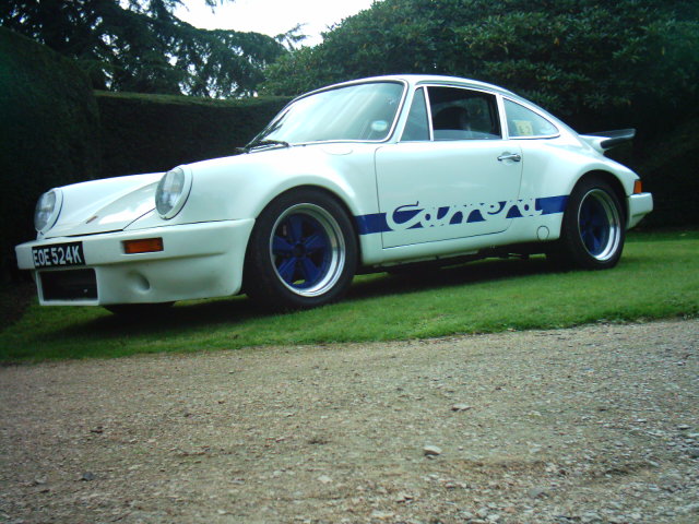

Two words...
Nick Moss.
He's just done a pretty good job on my early 911. Nick, if you want to post photo's, feel free !
