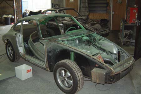

I did the same sill & wing repairs to my '71 911 myself, but am currently having the shiny sections done by Prospray who are the bodyshop used by JMH Automotive. They have experience of the older 911's and may be worth talking to. They seem to understand rust prevention!
I can't comment on the quality of their work until I get the car back [&:] but by all accounts the work they have done so far in preparation looks good. They are letting in several repair sections to the top side of the rear quarter panels so this will be a test of their fabrication skills! This was a litle outside my ugly but strong welding and metal work abilities!
Photo shows work in progress, with another 911 E being restored in the background
Prospray
