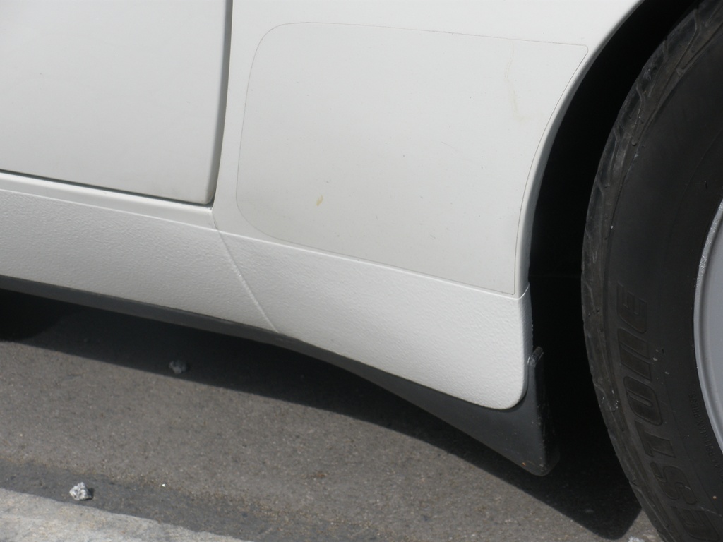

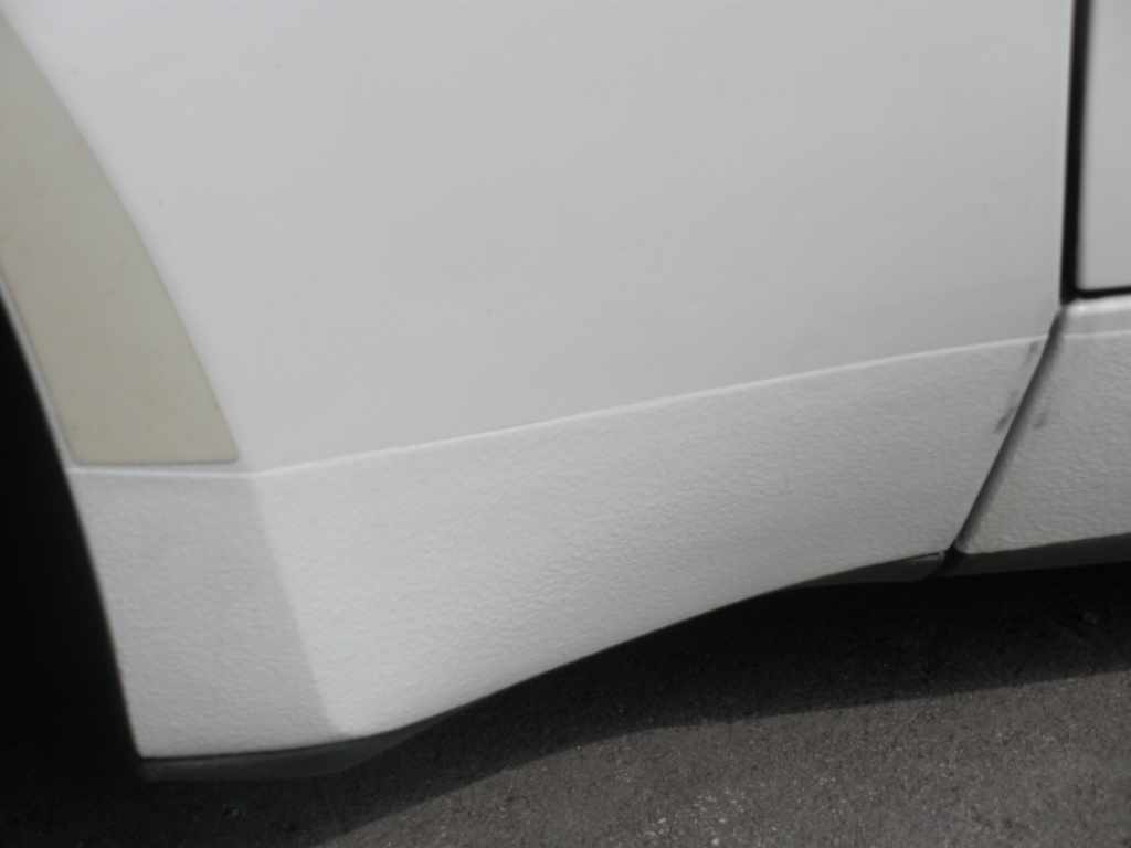

Impressively thorough (unlike the last time it was done by the previous owner/seller)...they cut out all the rust and replaced it with new metal, still managing to keep the repair below the stonechip line (a good reason for doing it sooner rather than later). All finished up with Waxoyl both sides.

At the rear wheel arch it's double skinned and the rust had started on the inner panel too, so fortunate I got a proper job done before it started eating into the cill!!

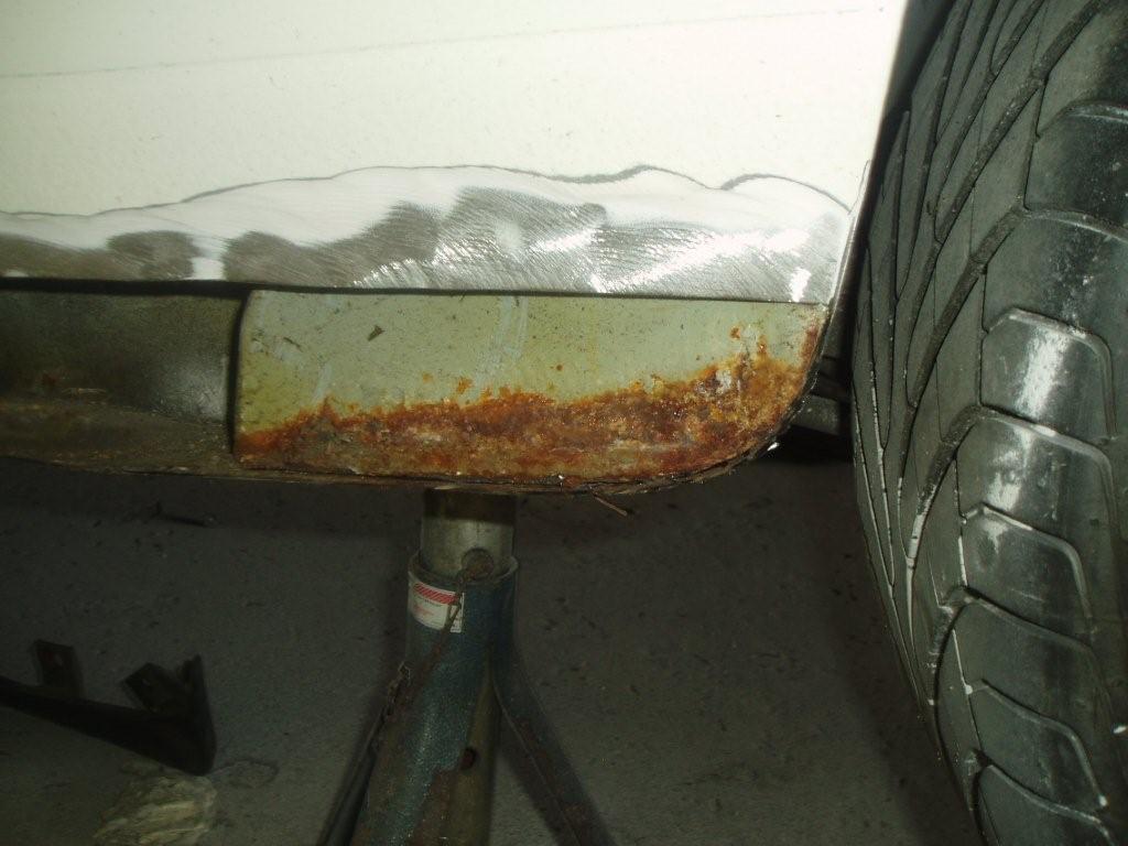

Hopefully I've just uploaded a shot of the stripped out cill/rear wing. If this works I'll do more!
Yeah that works Graham. Currently doing my drivers side (which was worse than that and a bit further forward), but expect my passenger side to look exactly like that when I get in there in a few weeks.
Interested to see the rest of the pics...............
That front wing looks just like mine did.

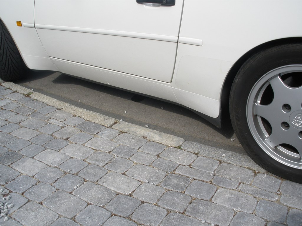

And the whole side....a neat job with the stonechip and with the colour (my car's at least two shades of white if you look carefully!)
...but not as fast as red, Nick!!
Seriously, with the nature of this repair I'm glad we've not had the colour matching problems of a metallic. I guess that's probably OK these days....?
