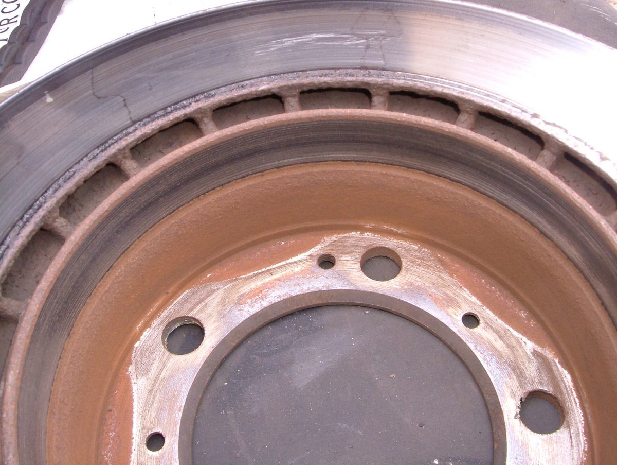

Here's a picture of my rear disc, not too much rust on the inside after 4 years use.
The inside part of the disc is for the handbrake shoes.
