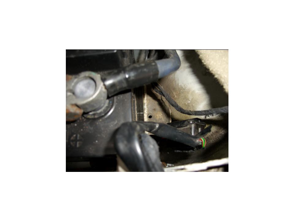

I had a look at the battery this morning and also took this picture. Am I right that the bracket/clamp (which is missing!!) should be bolted through the hole of the battery tray and then secured onto the battery's lower lip slot. It seems that some idiot had forgot to put it back (or lost it) while the battery was replaced.

This is the bracket from mine showing the "lip" that secures the battery down (had to get my battery out to charge it up).

Yes, the part number is spotted on. Thanks. Its quite an awkward position to fix the bracket and will require a short Allen key. I nearly dropped both the key and the bracket under the tray.
