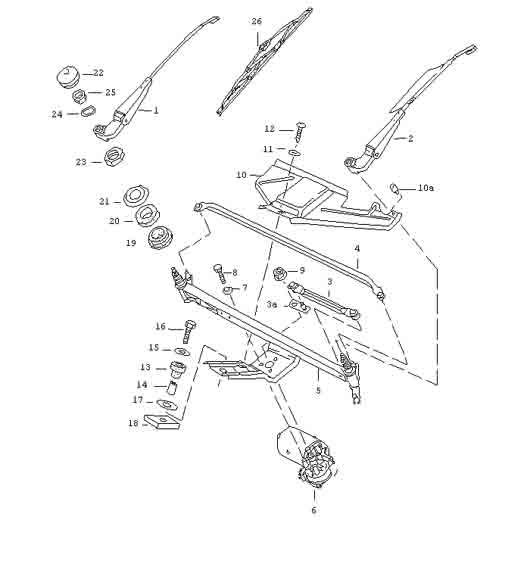

Here is the detailed front wiper system parts diagram and OEM part#. I think some guys have managed to get away by just fixing the long connecting rod '5' (944 628 034 00) without replacing the whole wiper frame '6' (944 628 961 00).
But it seems to me the wiper systems are different on the pre-85 and post-85 models where the pre-85 has a seperate short connecting rod '3' (on the o/s) and a different long connecting rod. This may explain why some found it easy to replace the o/s connecting rod without the need to disturb the n/s end - I think they maybe the pre-85 models.
It looks like on the post-85 models, replacing either the connecting rod or the frame will have to get under the plastic cover and discconnet both ends etc.
it is possible to put your hand in under and prize the link arm off on a post 86 but you have to be very strong and ignore the pain lol. to put the new arm back I used a long metal bar as a lever fulcrum to force it back on both ends
Sorry for loading the wrong diagram. I think this one is the correct one for 87-91 models and the frame is different from the previous models where there are two seperate connecting rod (the o/s one is slightly longer than the n/s one). I am thinking of replacing the o/s conecting rod '5' (94462803400) but not quite sure how does it attach to the n/s connecting rod '3'.
