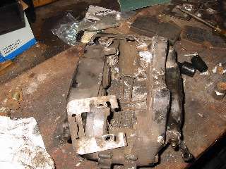

I've just re-built both front brake calipers on my 944S2 (what a co-incidence) having had the car 10 years. It was more difficult than I expected and I learnt a lot that I want to pass on in detail.
I've found a good source of seals for the calipers and took digital pictures of the re-build and am going to put together a helpfull web page! I've painted the calipers with caliper paint (temperature resitsant) and could not help myself but paint the "porsche" script in guards Red touch up paint.[:D] Should look nice through the wheels.
Off to the garage now to finish the job! Heres a taster!
I hope that's the before picture [:D]
Seriously I look forward to seeing the full writeup, as my rears are in desperate need
" I hope that's the before picture[:D] "
[8|] err, yes[>:], thats the passenger side front just after I'd got it off the car and got those pesky little bolts out which fix the stainless steel pad guide plates. You can see the corrosion that built up on the caliper body. This has pushed the plates out and partially siezed the pistons.
