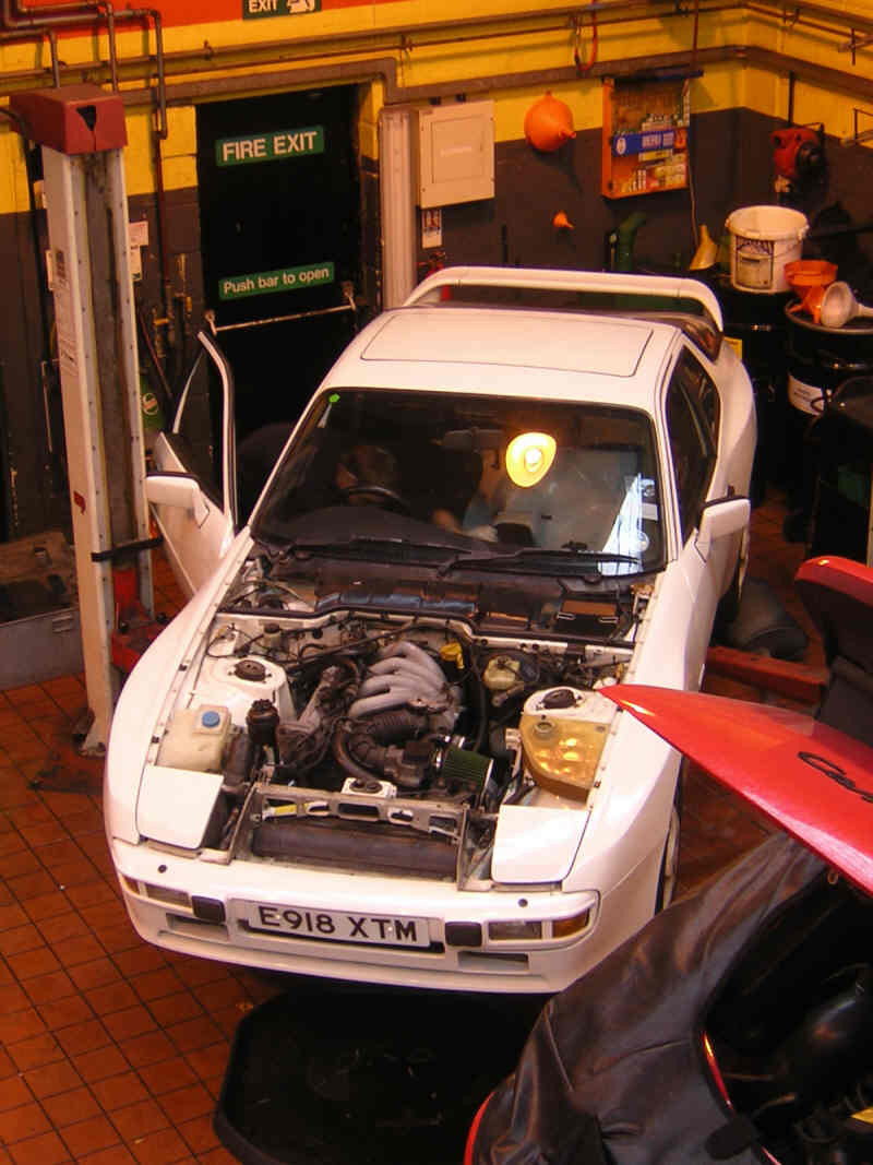

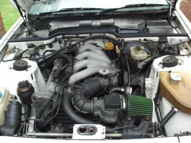

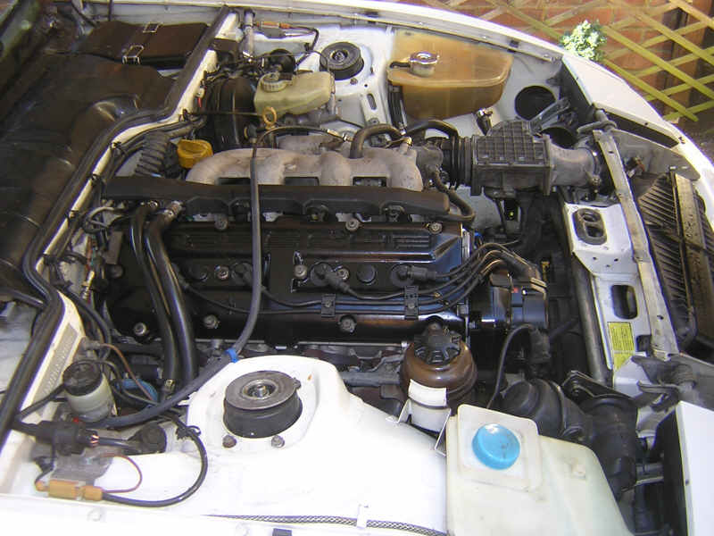

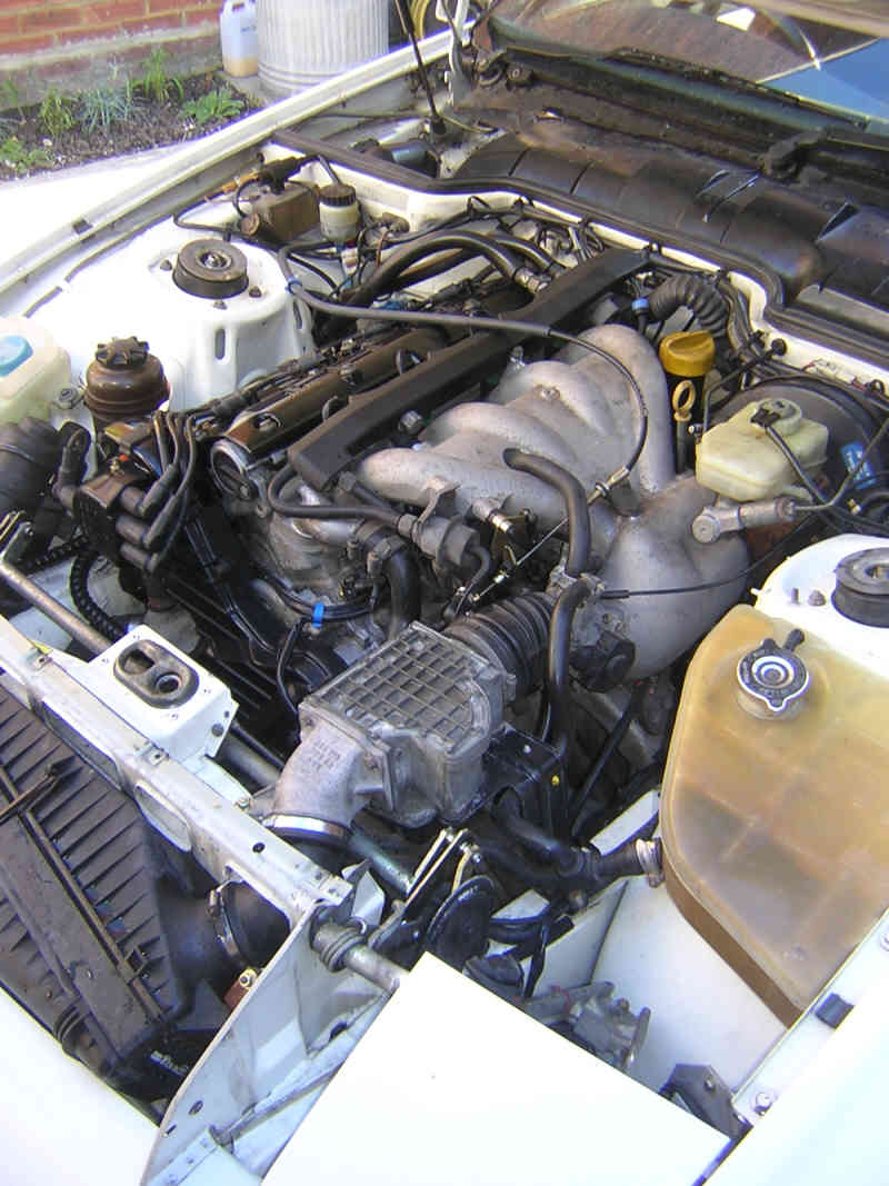

Thought I'd post some pics of the engine work.
Firstly here's the obligatory before shot...
I'll get a new header tank soon as it does let the side down a bit, and the rest of the bay needs a good clean too.
I'm quite tempted to pick the letters on the cam cover in white, which is borderline chav behaviour I suppose [;)]
The post wouldn't be complete without thanking Phil for the engine and gearbox, Dave at JZ Machtech for his extensive work in getting it all to fit, Nick for plumbing assistance and Simon at ESS for supplying one of his exhausts specially so it would fit through the slotted rear valence.

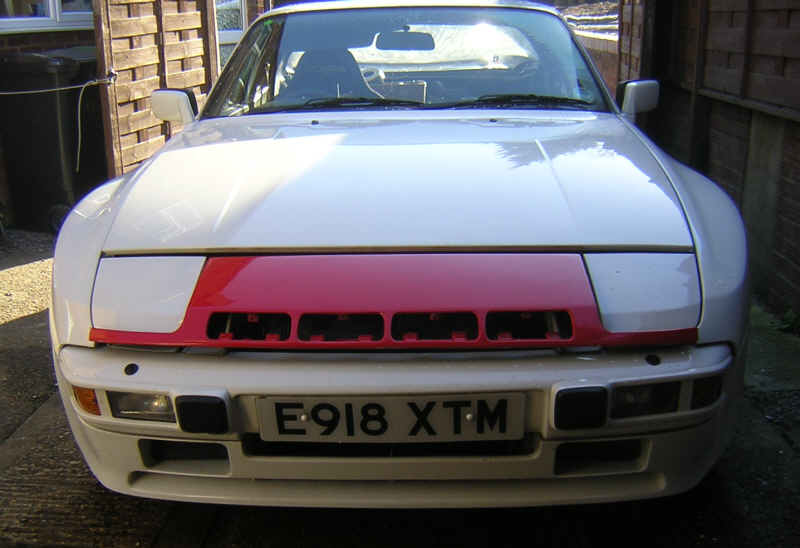

And lastly here's a pic of the vented panel that will provide some air flow to the intake. It's just resting in place here as we're still hacking bits off to get it to fit [:D]

The 924 Carrera front panel is also a smart option as this gives better airflow to the airbox.

Andy, I wish I was responsible for the install, but at the end of the day I just had the idea and then a few weeks later handed over payment, so I can't really comment on the intricacies of the install.
However I don't believe the electrics were too bad as Phil provided us with the original engine loom. The plumbing did prove to be a bit of a headache, which was where Nicks car came in very useful as they didn't have a another S2 in to compare at the time. Interestingly Dave mentioned that there seemed to be a lot of subtle changes on the S2's around this time.
As you say it is a big job, Dave spent approximately 45 hours (including gearbox swap and a few other odds and ends) doing the work, but at my request was very thorough!
The new parts list is comprehensive to say the least [:)]
The airbox will be going fairly soon as there's not enough room for the plastic vents once the badge panel is fitted, so I'll be fitting a cone filter instead, possibly with some kind of guard to keep it out of the direct path of rain/car washing.
