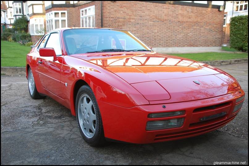

hiya all, have just [friday] had a full detail /paint correction to get rid of those little pink bits, i am very happy with the result, rob of glean-machine arrived at 8'30am and left at 4.30pm after clay barring, machine polishing etc he used all top products and i will be seeing him again in march/april, pics included, regards jason p

Top job, looks amazingly glossy I bet your proud!

Jason from those photos you must be well pleased......amazing result. I am definitely going to lock that in for mine. I gave it a go myself a few weeks ago but no where near that standard as an end result.

That is a very good result from a single stage finishing polish! How swirled was the paintwork before? Just wondered how much swirl removal you got from that particular polish.

The polish in question is Meguiars #205, it has unigrit abrasives which can be controlled to offer more or less cut depending on the pressure, pad and speeds used, the detail was an enhancement detail which is to add gloss, clarity and remove any light defects in a single stage, due to the oxidisation that is common on older red cars this proved to be an ideal polish to add back some vital oils.
This was by no means a full correctional detail as this would have involved multiple days and polishing stages.
