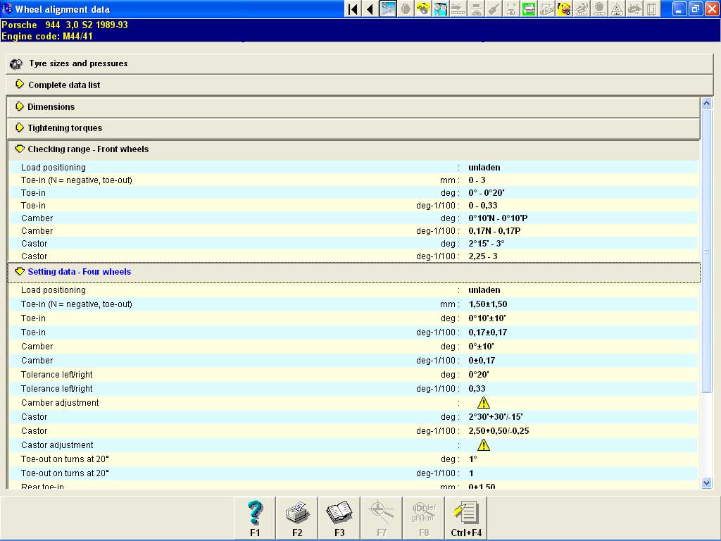

i need to adjust the tracking on my 91 s2 standard wheels and tyres i can do this myself but need to know the settings does anybody know them ?
best wishes phil
Grabbed these off my Autodata CD - HTH
thanks for that guys very quick response
