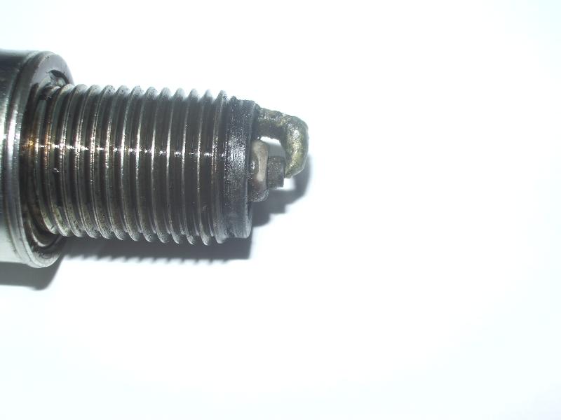

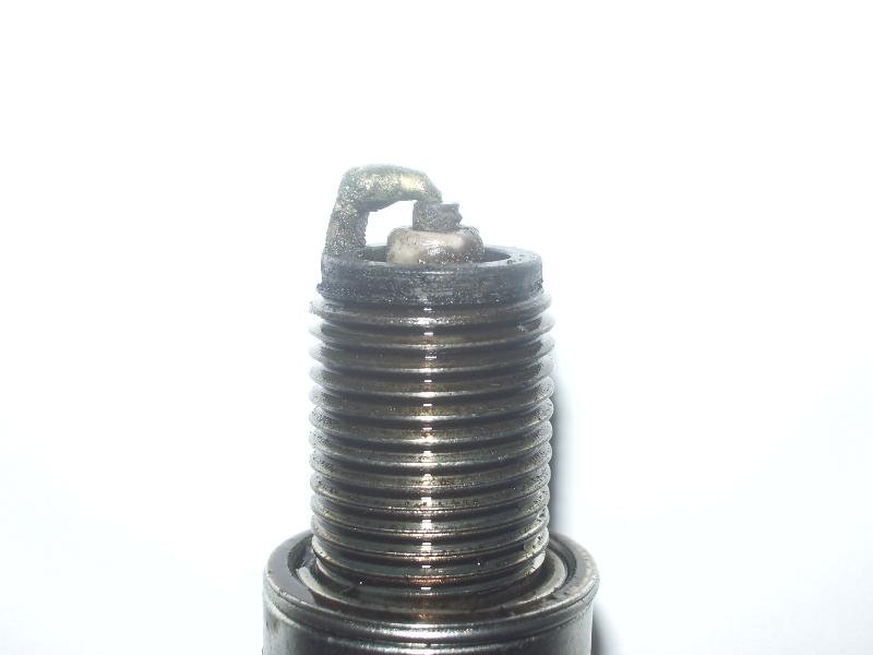

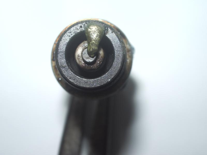

I did see 7500 revs on the tacho at one stage although I did melt a plug as I went through the timing light at the top end...
The plug gone meant my day was finished (why is it always the LAST one you change out of 8 thats the bad one lol)
I will add 2 pictures of the melted plug...
In total it was a great and relaxing day, got a lot of setting up done and will now move to NGK B9ECS (retracted nose plugs and 2 more heat ranges colder) to save melting any more, I will also alter the fuel/Nitrous ratio to a safer level, lol...

Hope you get the plug issue sorted. Just switching to a colder plug is really masking the problem, it would be best to solve why it's happeneing first and then go to a colder plug for safety.
