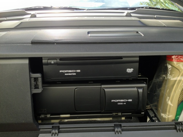

Clive - really good post thank you. You have given me a direction to go in and I will have a surf around and see if I can get a unit for the DVD drive in my 2005 C2S. The unit is actually in the boot above the CD auto changer - hopefully I have managed to upload a photo of it.
