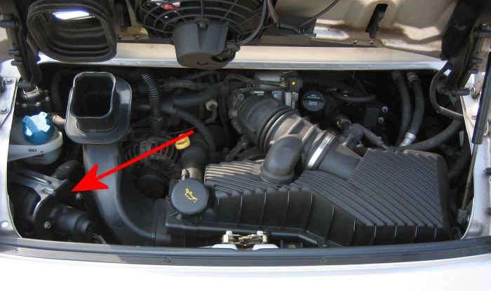

Richard, can you tell me where I can find the pump as I want to disconnect it myself and see if it the real problem here.
The most gutting thing about this is that the job to replace is only 30 mins (if that is the problem)
You can see the pump here, and there is a plug/socket to disconnect it:
OMG!!!,
I think I may just have to have a go at this.
Richard, prepare yourself. I am going to have a go at disconnecting the plug and start the car.
That way I will know if its air pump thats gone.
Gonna have your mobile number set to speed dial just in case (Joke!!!)
