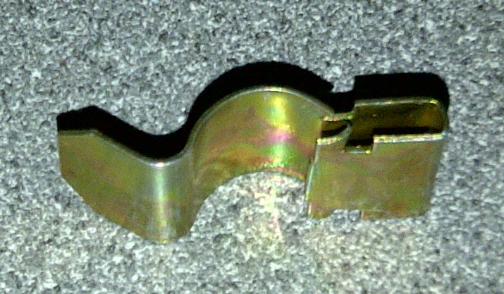

Finally got around to fixing the non retracting seat belt today and was amazed by what I found.
This trim clip (see photograph) was wedging the seat belt retractor and preventing the webbing from rolling back onto the drum. Simply picking it out of the mechanism seems to have been enough to effect a repair.
Unfortunately, I can't see where its come from. Looking at the side panel there doesn't appear to be any place for it. Can anybody suggest where it might belong? It doesn't appear to belong to the seat belt at all.
By the way, thanks for the advice Richard. Spot on as ever.
