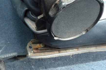

My 911SC has only one bolt at the rear on each of the seat fixing rails, been that way since new, I believe
And to prove it, here's a photo, looks a bit rusty; hadn't spotted this,so now I'm going to have to dismantle the seat fixings to clean this up! I have a set of small sockets, the only way to get at the bolts.
Interesting stuff. The single bolt on my 84 3.2 [usually 2 ]is so far under the deat that it is really difficult to remove it without the threaded plate falling of in the track. Is yours the same?
Thanks and best wishes David
Regarding getting the screw started, I would try two things. Try holding the screw with Mole grips. That might let you give it half a turn or more to start.
Another option might be a longer screw with the same thread. I had a feel around under the rail and think there's enough clearance there to tolerate something about 1cm longer?
