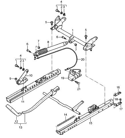

I had a rattle on the seat frame of my C2 which sounded like the back rest, but was the rear pivot point of the height adjuster. There is a nylon bush which had worn through, giving metal-to-metal contact between the pin and the pivot arm. Item 2 on the attached. It was a bit of a pain to remove the seat and strip it down, and there are some 'special' tools required - an E12 Torx star socket for the seat bolts, and a spline drive bit for the pivot pins, but it wasn't too bad once the seat was out.
