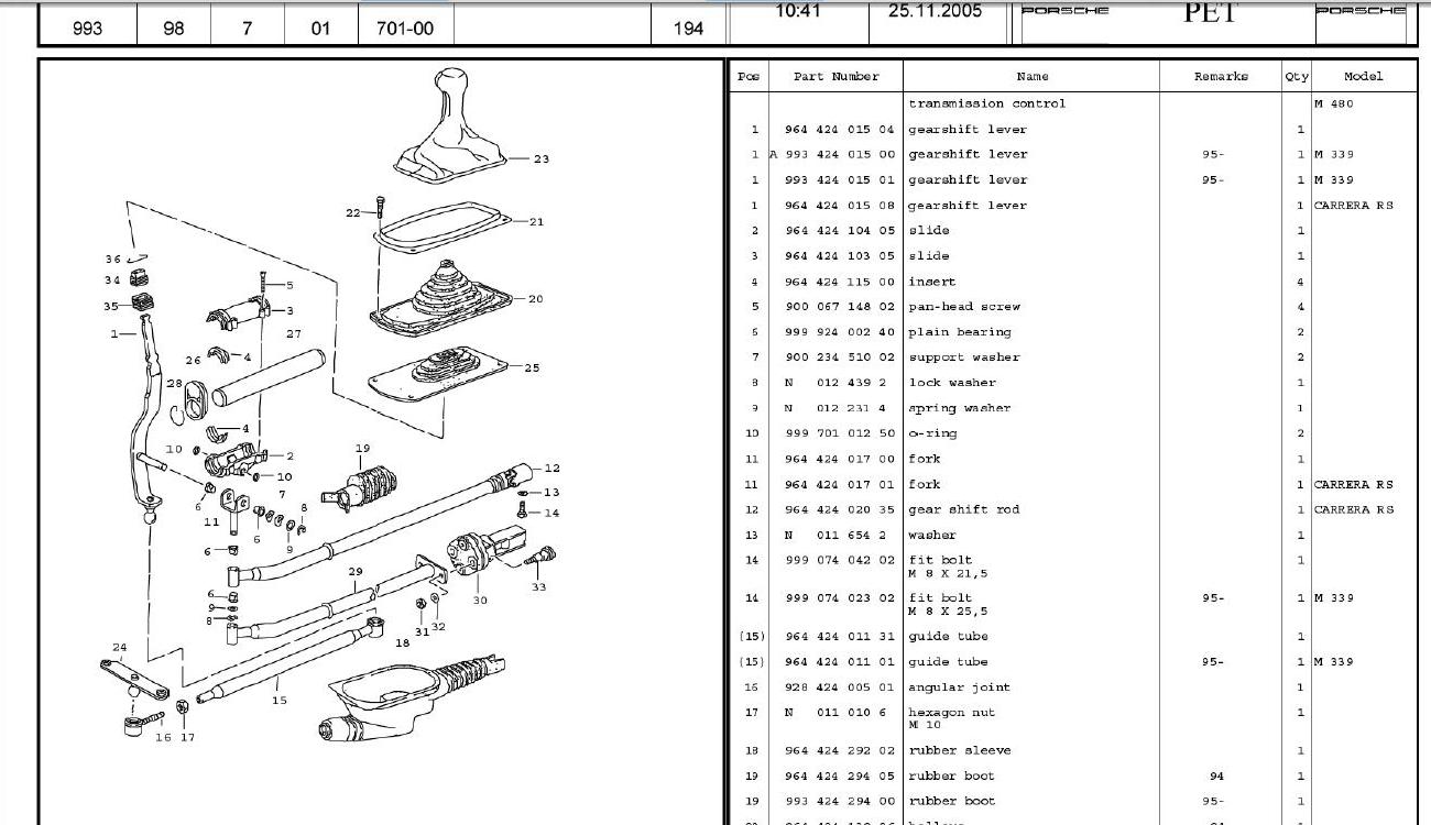

That clip looks like the split clip which attaches the gear knob to the shaft.? (No36 in the diagram)
Maybe its come away.. Does the gear knob move or twist at all.?
cheers adam

Adam, thanks.
No, it does not, but I see what you mean from the picture - it could be partly off and about to fall apart.
I need to open it all up anyway to get the console replaced, so I'll do that and will probably learn what's going on when I can see under the gaiter.

The gaiter is just kept in place with 4 (I think) push fit clips and can be easily prized up, so you should be able to check out the strange clip thing.
The gaiter can be pulled up easily, and that is the no 36 clip in the diagram, but it doesn't come into contact with the console on my car. I wonder if your console top has moved back slightly?
