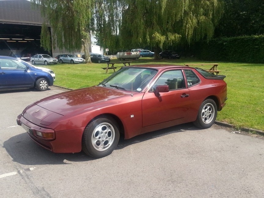

That 2 stage wooden picnic bench on the rear hatch probably slows it up a bit[:D]
(only joking - look at the pic of your car above[;)]).
