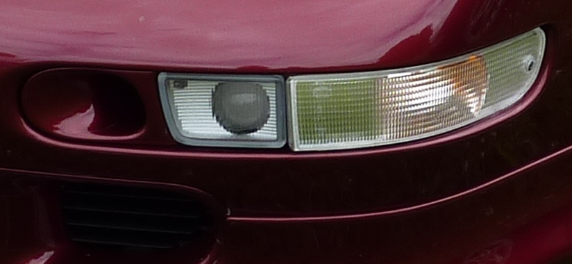

Hi Phil
My friends has the Ducts and the side light is mounted in the top corner of the Fog. Looks like a factory thing too.
Have attached a pic for you
Graham
Arrh, that's how it's done! Thanks for the piccie Graham.
Looks like I'll have to modify my indicator, however, I'll now need clear indicators!
