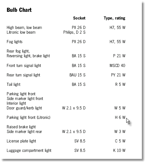

Hi, hope someone can help, i don't have the manual to hand and need to know what bulb to get to replace the sidelight that has gone this morning. Anyone know the part number or better still where to order one cheaply? Car is 2004 Boxster S

Do you have litronic lights?
If so the bulb is different, and will cost rearer to £5 than 50p...[:mad:]

It's the litronic ones i need so i'll go to local factors rather than Halfords. OPC wants 40 plus VAT (that includes the bulb how nice ;) )
You might find one in Halfords (about £7 I think I saw it for), but the little book they have didn't list it for the Boxster - only the standard bulb for non-litronic cluster.
May have their documents corrected by now though?
I have had great difficulty finding this bulb in motor factors, Halfords etc. It is very unusual and I think I've only ever seen it once in a shop (Halfords [:D])
Easier to buy online and have it turn up the next day [8D]
Been to a motor factors got two for £8.99 :D H6W on the bulb and made by RING so i guess its right.

All working for £8.99 however, as someone else said on a post here, they go in pairs. I'd just done the failed one, tested it ,and the other one had blown too so no spares left for the toolkit :(
