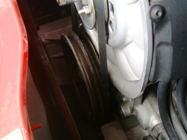

This photo is the crank pulley arrangement on my 964RS Lightweight.
The additional pulley wheels would be for the non-existent air-con/power steering/anti-smog device. This pulley wheel is on the end of the crankshaft - lightening the pulley will not add any more horsepower but does leave more of the horses available to accelerate the car because less are wasted accelerating the crankshaft. This is surely a neglible effect as the pulley only weighs 1.162kg so estimating, optimistically, if we lose 2/3 then we are saving - 0.75kg? There will be less inertia in the powertrain yes and a negligible effect on idling.
Although there should be no rotational effect I'd consider that as the engine was conceived with the large pulley - that's how the crankshaft should be dynamically/harmonically balanced.
