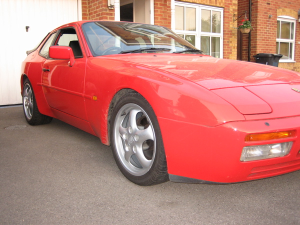

Thought you would like a photo...
Nice pic!

Still have the others, but could not resist the cups when I saw them... [:D], don't suppose you know anybody that wants a set of 5 spoke splits? my garage is not as big as yours [;)]

Think the Cups look great. Glad odometer ok- so if you get cog from USA you'll have a spare
