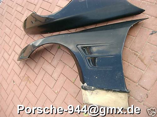

I have come across these front wings on the German eBay site, not my cup of tea! They seem to have a Mercedes SLR look about them.

On my first post I did say "Not my cup of tea " I posted the SLR style wings because they were diffrent thats all ! I do believs the GRP wings are mainly used for track or race cars to reduce weight , so the perfect fit is not so important when hitting a tyre wall ! .
