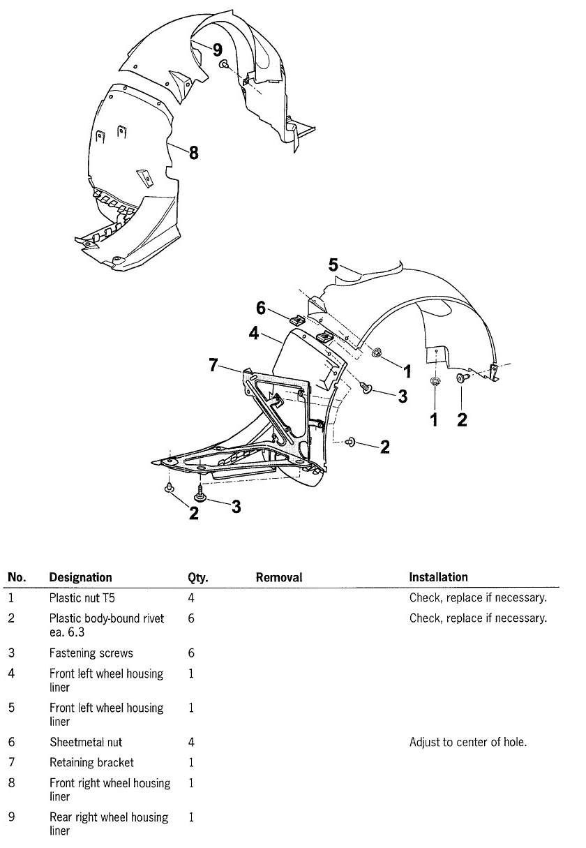

Advice from local OPC is to remove inner wheel liner, remove pump motor from bottom of reservoir and thoroughly wash through with a hose. Might give it a go if I can get the liner off.

Job done. wheel arch liner (rear half) removed - thanks Richard for drawing. This exposed the reservoir tank and enabled the washer motor to be prised out of its grommet. Horrible, gungy, smelly water cascaded out. Flushed through with hose pipe several times and flushed the windscreen and headlamp washer hoses as well with fresh water. Re-inserted motor in grommet and re-fitted liner. Have left reservoir to dry before putting in about 1-2 litres plus screen wash. Tank filler area already smells neutral so hopefully all done. Lesson learned.
