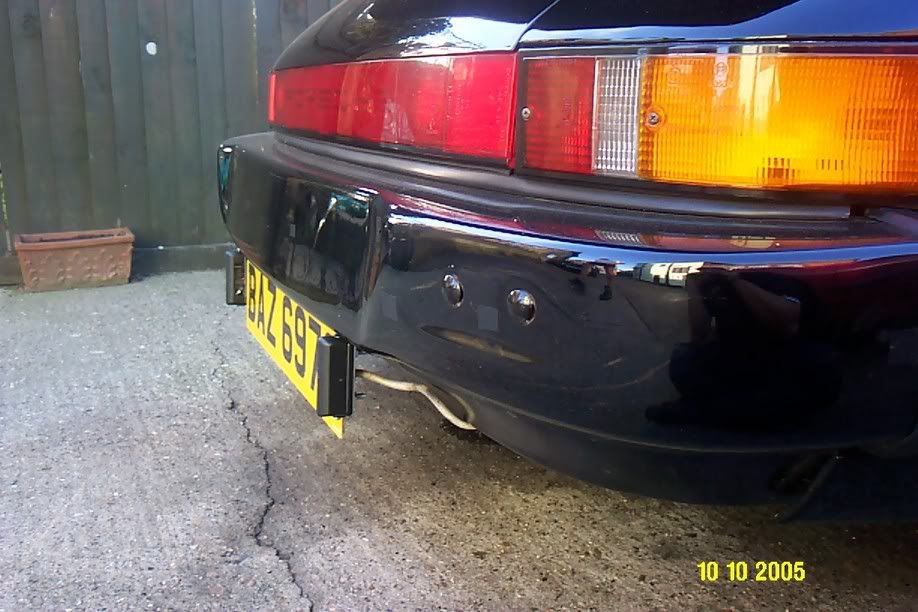

I have now moved the back number plate and smoothed the bumper although the holes are only taped up at the moment I will get these welded up soon. I will try and load the pictures as well. File to large over 200 KB how do I load them as an attachment?

How did you attach it without the bolts on the outside?
Piece of stainless with a 90 deg bend that is sandwiched between the bumper and valance with the bolts passing through it that hold the valance on. The lights are bolted through from inside them and the number plate is held on with double sided tape. When I get some small rubber gromets I will drill holes in the valance and hide the cables as well.

I drilled out the original bolts that are welded to the support bracket and fitted coach bolts from the outside, these have got a dome shape head and a square shoulder underneath the head they just about cover the slotted hole in the bumper.
When I get the other holes welded up I will get the whole bumper sprayed together with the bolt heads. Coach bolts are available from good iron mongers or engineering suppliers I used 8mm x 50mm galvanised bolts.
