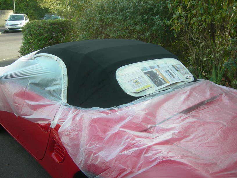

Valeters overcome these by using a garden blower to speed up the drying process, using a plastic dust sheet (£3.99 from B&Q) with a hole cut in it and masking tape to cover the paintwork, trim and glass (see attached picture) and using a portable shelter on-site or working indoors.
