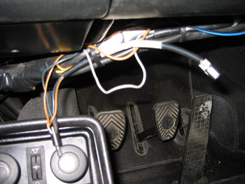

Q1) I have no idea why I have this hanging down from below my ashtray but it does have a light on the end of it. It lights when the headlight switch is operated.
Take a look at the image I have uploaded. The round connector on the left hand wire holds the bulb. The right hand wire has a connector too but this doesnt go anywhere at all. Has the light fallen down from somewhere? I dont really know where it goes, lol.

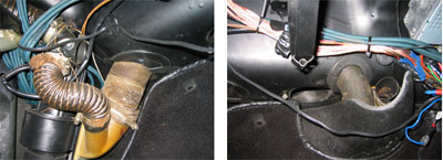

4) I also need a couple of air pipes which go from the LHS footwell blower. Can these be sourced and can any air pipe suffice. I think the part numbers are as follows; 911-573-115-00 and also 914-572-123-10

Just to go with the above post I thought I'd add the problem I have with the air pipes. The image below shows the missing pipe and the broken pipe. I believe the missing one (in left hand image) goes to the "empty" hole (in the right hand image). is this correct?
Thanks again for any help.
Chris
Dont know about the heater pipes but the light bulb is probably for the heater slider. There is a bulb at each end from what I remember on mine - feel around you will find a round hole that it slots into.

Aha!! I think I have a result on the connectors in the picture I posted.
I have found several connectors tucked away which all house small 12v 1.2w Bulbs. Most of the ones I have found do go behind the heater control panel. The one on the right hand side in the picture I think is the ashtray light. The actual fitment is missing so the connector has no place to fit into. I do see where it is supposed to go now and have bought the light housing (fits in hole above ashtray!).

The pipes I require arent the rubber ones. I require what appears to be an alluminium pipe and also a nylon / plastic pipe as in the above pictures. I'll find them from somewhere.
