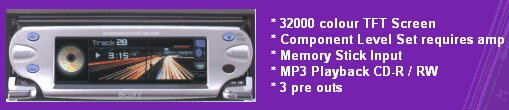

I'd also be interested in this as I have a lovely Sony MEX-DI (I think that's the number) CD player which i'd love to put in in place of the Porsche CDR-22 i've got but understand that it's a bit of a nightmare changing it over.
Elliott - many thanks for inadvertantly reminding me of this![:D]
It's got a fantastic LCD front screen into which I can apparently load memory stick films I have recorded and play them on the screen.
Very gimmicky but just so cool! God, you can can tell i'm not the technical brains in my household - i'd have bought it just because it looked pretty!
<blush>
MEX-5DI ?
There you go...........
Now Dawn, Tell me how i fit mine please [;)]
That's the one! I've had it three months now and i'm none the wiser![&:]
Having said that, a friend of ours who is particularly adept in all things stereo is popping over this weekend to have a look at the connections. The only thing I am worried about is the fact that you can't remove the front screen for security when you leave the car!
Never mind. If I can get anything concrete from our stereo chappy i'll be sure to whisk the information your way.
