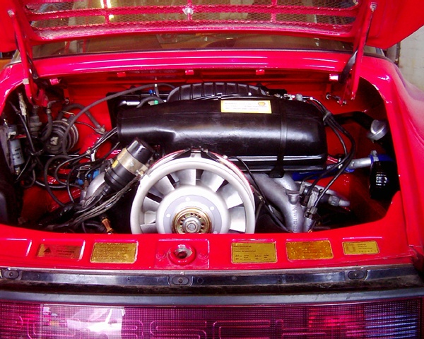

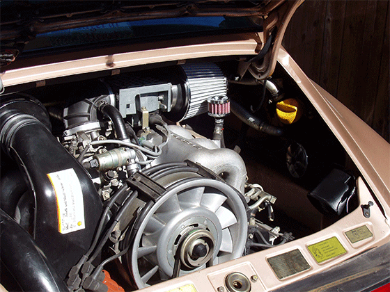

Use wet + dry on it , see results on my fan last year taken after about a 1-2hours work, only thing I did not do was to give it a clear coat of lacquer so will have to do it a gain this year
All three of those look really good and about 10 times better than mine currently does. Just one question, can you get the fan shroud off while the engines in the car? My shroud is now loose but doesn't seem to want to come clear as its catching on the crank pulley. If I'm going to get the fan powder coated I may as well get the shroud done as well, but I've certainly no plans to remove the engine to do this. Could somebody let me know if this is possible as the Heinz manual is not very detailed. Thanks.
