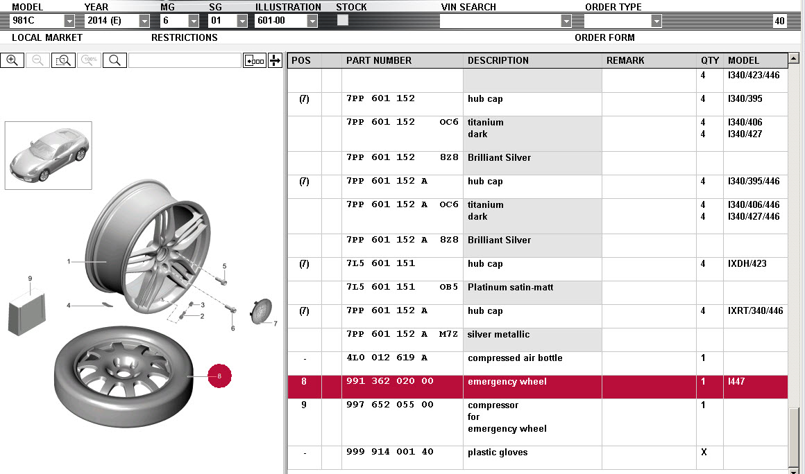

Porsche offer a space-saver spare for the 981/991. Option code I447:
There is also an adaptor for Centre lock equipped cars or at least there is for 997 (997 362 191 0). I wonder what diameter the 991 spare is?

I expect you would have to do something like this: http://www.porscheclubgbforum.com/fb.asp?m=690601
I bought a second hand jack from Porsch-Apart, and the other bits and pieces from Porsche (Wheel alignment tool, plastic bag, etc).
Edit: also see here: http://www.porscheclubgbforum.com/fb.asp?m=729573

Thank you once again for the useful information. How do you access the parts database? (see edit below)

Added in Edit: http://www.porsche911.lt/files/981/E_981_KATALOG.pdf - courtesy of FAB944 on P9.
