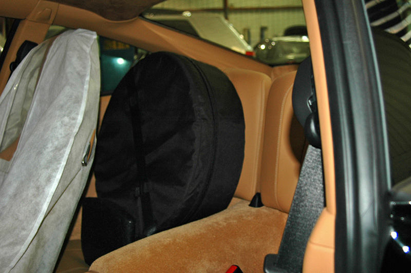

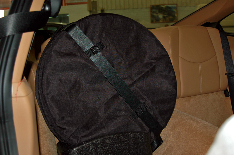

Are they having a laugh - the 'boot' is nothing more than a large plastic bag to store the wheel in (and the punctured one should you be unlucky). Its permanently on show on one of the rear seats too - for that money it should be leather trimmed toi match the seats !
another pic..
The same spare (deflatable) will fit in the front boot but you lose half your luggage space, and a punctured wheel will NOT fit in the boot anyway. The pics below show home made bracket that was used to locate the wheel securely.
