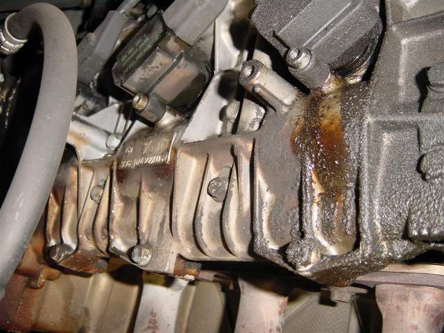

You can see the oil in this pic. Right above the oil is the spark plug coil. Under the coil is the tube and inside the tube is spark plug. It is a plastic tube with an o-ring on each end.

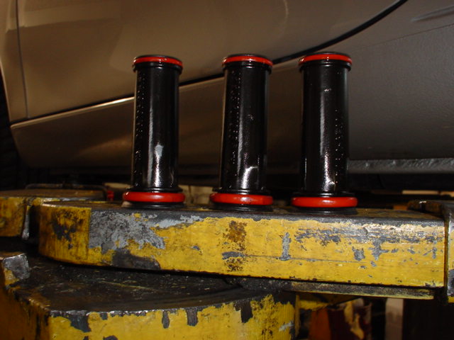

Here is a picture of the tubes.

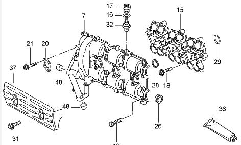

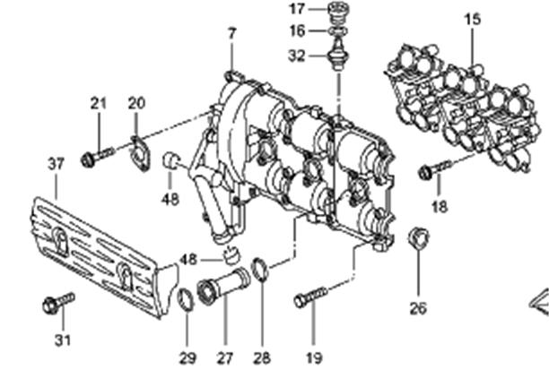

Yes it is. They slide in from the outside, sealing the gap between the cam cover and the cylinder head, and are prevented from coming out by the coil packs. On 3.6s the cam carrier (15) itself forms the 'tube' and has 'O' rings on top and bottom faces (28 & 29) to provide the seal.
